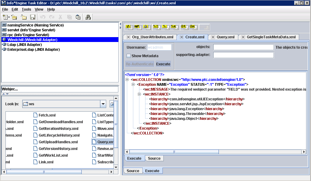

How to pass an object for an Info Engine task in the Info Engine Task Editor?
I want to create a WTPart object using the Info Engine Task Editor.
It is asking me to pass an object as a parameter.
Please tell me how to pass an object in the objects field shown in the below snapshot.

May 14, 2015 2:59 PM UTC
Can you show IE task? Also detailed error message?

May 15, 2015 6:40 AM UTC
IE Task
<?xml version="1.0" standalone="yes"?>
<%@taglib uri="http://www.ptc.com/infoengine/taglib/core" prefix="ie"%>
<!--com.infoengine.soap.rpc.def
Create one or more new business objects and store them in the database.
@param com.ptc.windchill.ws.GenericBusinessObject[] objects The objects to create
@return com.ptc.windchill.ws.GenericBusinessObject[] ${output[*]} The created objects
<ie:webject name="Create-Objects" type="ACT">
<ie:param name="instance" data="${@FORM[]supporting-adapter[*]}"
valueSeparator=";" delim=";"/>
<ie:param name="group_in" data="objects"/>
<ie:param name="group_out" data="output"/>
</ie:webject>

May 15, 2015 3:13 PM UTC
Your IE task seems incomplete to create an object. Check following webject example and modify for your requirement. "file" is a parameter needed for document name.
