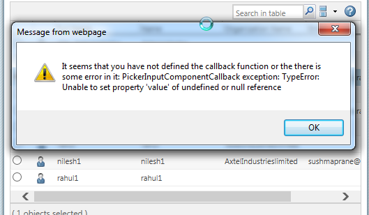

How to put user picker in table builder
I tried doing it by using data utility but i am getting runtime exception "callback function is either not defined or there is error in it.unable to set null reference"

Above data utility code I have written for user picker but when I seaech for user and click ok,I get exception as shown below.It means that I need to write a call back function.

I created a callback function in a .js file that is included in the .jsp for the action.
