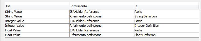

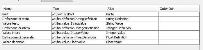

Maybe something like that.
Sorry but I have translate some definition.
Marco
