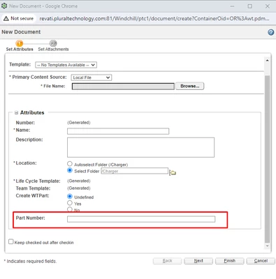

How to read Attribute value using form processor and perform further process
How to read attribute value named as, "Part Number" from the WTDocument creation page and perform further operation using form processor
expected - Read attribute value if it contains value then need to create WTPart with same number as passed in this attribute.

Hi @RS_10128209
In your processor, there is NmCommandBean input variable, this variable contains all what you need from the wizard
// NmCommandBean nmcb
public FormResult doOperation(NmCommandBean nmcb, List<ObjectBean> var2) throws WTException
nmcb.getChecked();
nmcb.getText();
nmcb.getTextArea();
