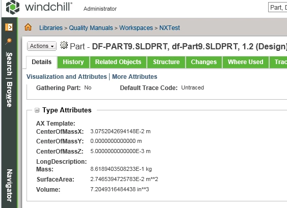

I have mapped some mass properties of Solidworks to Windchill 11.0 M020, but the values displayed are upto 13 decimal points.
Is it possible to reduce the value to get only upto two decimal points. If yes, please suggest

Irfan,
  • It is currently not possible to configure number of decimal places displayed for real value attributes
  • Real value attributes on EPMDocuments and related WTParts are always displayed with full precision (up to 14 significant digits)
  • Works to product specification for Windchill 10.0 - 11.0
You can file product Idea.

See CS355753
Basically create 3 attributes and use them as calculation for 3 decimals (Or whatever number of decimals you want)

Try to search PTC Support for CS355753.
Attribute with 3 decimals.
