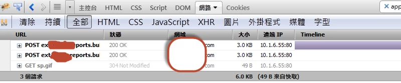

These are piecess jsp and javaScript Code.
<%@ taglib prefix="mvc" uri="http://www.ptc.com/windchill/taglib/jcaMvc"%>
<mvc:tableContainer compId="ext.reports.builder.TreeReport" height="500" />
<script>
function submitParameters() {
var params = { number : 'variable' }; //pass new variable
PTC.jca.table.Utils.reload('ext.reports.builder.TreeReport', params, true); //to reload the tree compoment and add new variable.
</script>
The javascript API 'PTC.jca.table.Utils.reload' throw exception when the store be reloaded.

I guess PTC.jca.table.Utils.reload is not support Tree table? I have use this funciton to reload table compoment and run correct.
Actually this issue is not big problem,Browser just to request Windchill server twice.

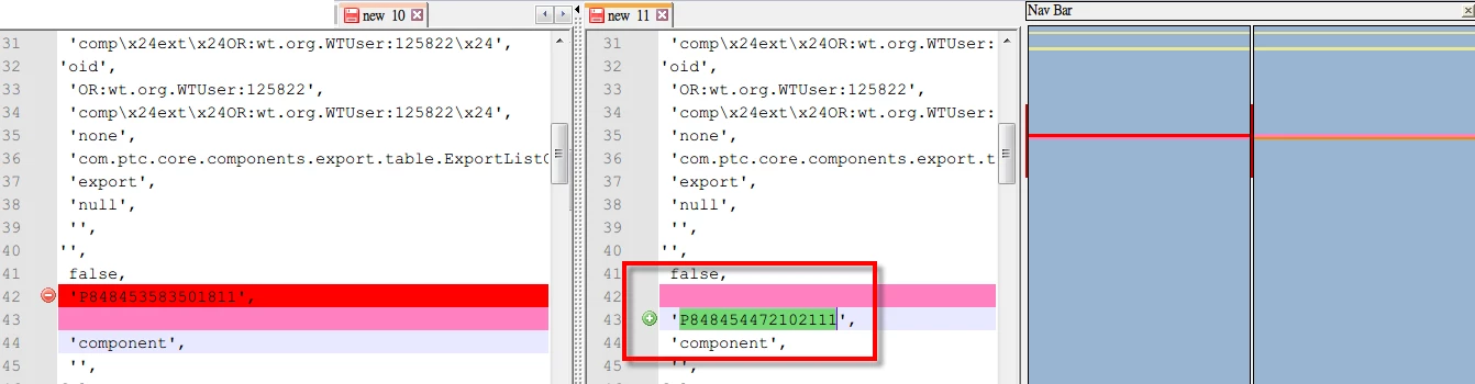

I try to compare first result page to second result pages.They are the same but unique Key.
