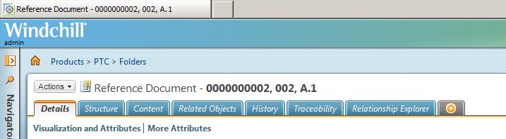

How to remove the default tabs"Structure" for a subtype of WTdocument.
Hi,colleagues,
Could you help me in this case ?
I need to remove this default Tab"Structure" in the object"Reference Document"
WCTYPE|wt.doc.WTDocument|com.ptc.ReferenceDocument

  • update -file docsb-actions
<?xml version="1.0"?>
<listofactions> <objecttype name="docsb" resourceBundle="com.ptc.windchill.enterprise.doc.docsb.docsbActionsRB"> <action name="docStructureGWT"> <command url="netmarkets/jsp/docsb/docsb.jsp"/> <includeFilter name="HideHistoryTab" />
</action>
  • create HideHistoryTab.java and class
  • create servive HideHistoryTab in the file service.properties.
briefly that way I could do.
