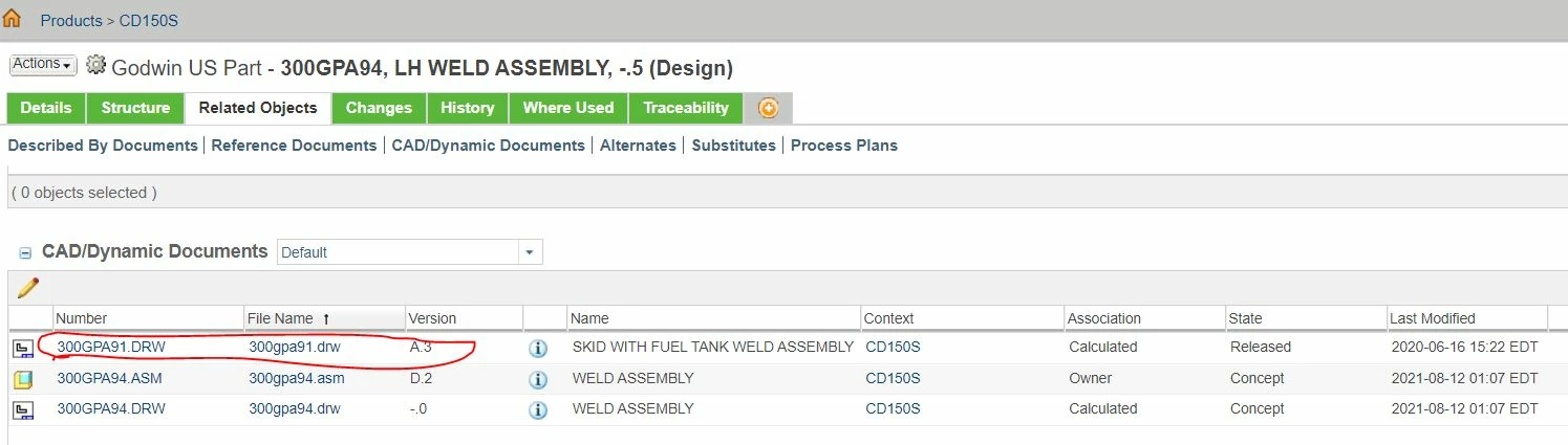

How to remove unwanted calculated, Old revision drawings from WT Parts?
Detail drawing was added with another drawing number in previous version. After that drawing is been broke out and created separate drawings with its own number.
Now, when I associate CAD part, previous version of another drawing appears as calculated.
I don't know how to remove this.
As shown in image drawing 91 is unwanted. Current revision of 91 is "E" that don't include detail of 94. But Previous version of 91 (i.e. A) appears as calculated.
Feb 13, 2024 6:41 AM UTC
Unfortunately there is no such option. I still belief that this is an error in calculation. I struggled with PTC support a few weeks ago and lost it. This is not accepted as a bug. The only way to remove the drawing from the WTPart is, to checkout the "RELEASED" drawing, remove the CAD Model and checkin the  drawing without the model. This makes no sense, but is the only solution which works.

Have you try to revise the CAD Model with WTPart without drawing? it should correct the relations.

Do you mean to say, associate only CAD model with WT Part, not drawing?
HelesicPetr
Feb 13, 2024 8:03 AM UTC
Yes.
