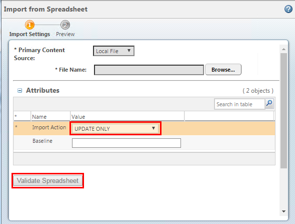

Hello Serge,
The import sheet works just fine.
  1. On the Import Action, choose Update only
  2. Before importing, make sure you Validate the Spreadsheet and do a Preview.
Send me an email if you need further help.
