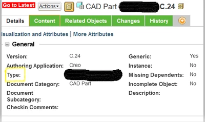

I have a ".prt" file which uses a "X" template and now ".prt" is in "B" revision.
Now, I want to use the "Y" template for that .prt file
FYI: I have 1000 of .prt files need to use the "Y" template.

It is not possible to replace a template. A template is used only for initial creation of a part, assembly or drawing.
You can create a mapkey that has the changes that have been made to your initial template and apply that to change the existing parts.

Yes, I agree with your note.
Actually, the scope is to change the Template in order to reflect those in the "Type" Attributes as shown in the image.

Feb 24, 2022 2:28 PM UTC
My system shows that as being CAD Document which is NOT the name of the template that we use for part initialization.
