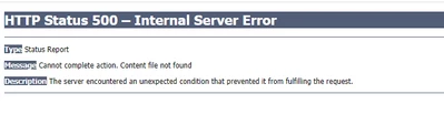

In continuation to this topic. Now Im at last step of Enhance Migration where we need to run a batch script and I have ran it.
"copyScript.bat" has generated in source location.
The question is, Im not getting how to run that .bat file to see the content of my object.
Could you please guide me for the same?

Hi @RS_10128209
You need to verify the vault configuration and the mount of vault in the target system.

Hi @RS_10128209
What the bat file contains?
Are there copy rows to copy vaults from source location to target location?
If so, then you should think if the folders paths are correct and change it if it is necessary,
The copyScript.bat file is a BAT file so it is executed from a command line CMD or Windchill Shell.
You just run CMD and run the bat file from there.

Hi @HelesicPetr
Yes it contains the copy row of contentmap table.
Locations are correct and I have ran the copyScript.bat file in CMD but still the unable to open

Hi @RS_10128209
