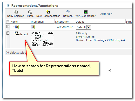

How to search for a representation by name?
Hey,
I need to find all CAD Document representations named batch and delete them.  Any good ideas on how to go about that?
System: Windchill 10.1 m040
Thanks for the help,
-marc

Just to wrap things up,  I was able to use a SQL query to find all the representations named batch and then use the DeleteRepUtil to delete them.  I chose to use this method because it was faster and had less impact on the running production server.  The same results could be achieved using just the utility, but it was much more resource intensive and disruptive to the server and user performance was noticeably affected.
My Procedure:
  1. Log into DB server
  2. Start MS SQL Server Management Studio
    1. Login as db user
  3. Run SQL query
  4. Save results to text file.
  5. Copy text file to APP server.
  6. Break single large text file into smaller files of approximately 5000 lines each as needed to minimize impact to performance.
  7. Start Windchill shell
  8. Run DeleteRepUtil  with the -f option to read the file.
