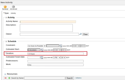

I want to set Duration attribute of Plan Activity to hours instead of days. By default it is taking in days only.

I suspect that this is hardcoded to render days and there is some calculations going on here. I would this that decimal portions would work to get you hours but it would likely show a partial day. If you are looking to have it render hours, I might suggest a customization of a data utility to alter the display of the variable.
Last thing you can try is see if it accepts a pure unit suffix (I doubt it):
https://support.ptc.com/help/wnc/r12.1.1.0/en/index.html#page/Windchill_Help_Center/typeattr/TypeMgrPureUnits.html
If you entered "8 h" or "8 hr", if it was supported, it would accept that as hours. This is how unit based IBAs work.

Seems to be doable with customization.
When I start a new activity plan the default is now 1.0 Hours rather than 1 day.
