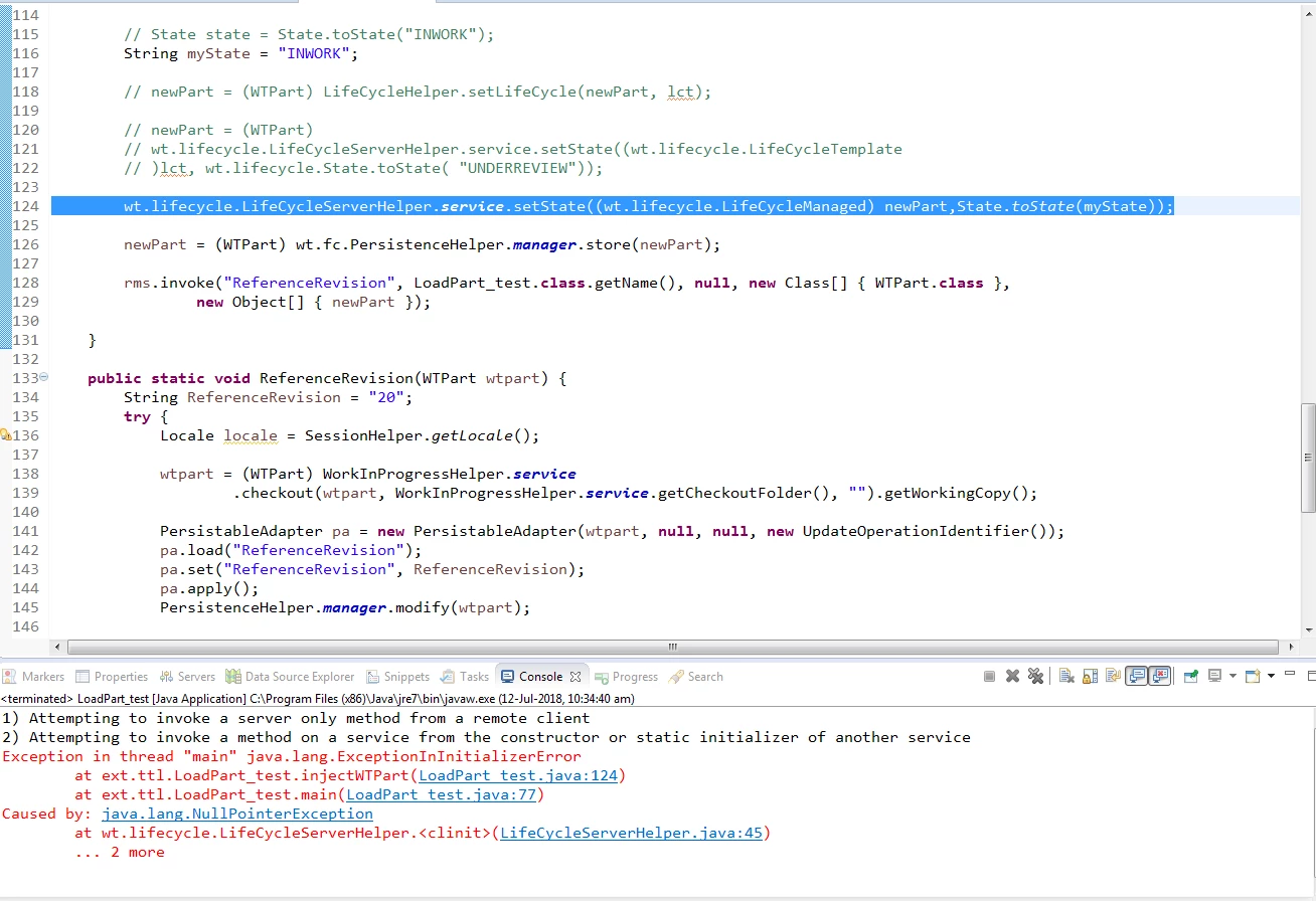

Jul 12, 2018 5:07 AM UTC
I tried that and getting this error.
Exception in thread "main" (wt.fc.fcResource/0) wt.util.WTException: The operation: "setLifeCycleState" failed.
Nested exception is: wt.util.WTRemoteException: Unable to invoke remote method; nested exception is:
java.rmi.ServerRuntimeException: Server exception; nested exception is:
java.lang.NullPointerException
at wt.method.RemoteMethodServer.invoke(RemoteMethodServer.java:788)
at wt.services.ServiceFactory$ClientInvocationHandler.invoke(ServiceFactory.java:349)
at com.sun.proxy.$Proxy13.setLifeCycleState(Unknown Source)
at ext.ttl.LoadPart_test.injectWTPart(LoadPart_test.java:118)
at ext.ttl.LoadPart_test.main(LoadPart_test.java:77)
Caused by: java.lang.NullPointerException
... 5 more

This is an issue with your setup. You apparently are not running this on Windchill itself eg: jsp page, workflow, etc.
See this article for running code from a java client:
https://www.ptc.com/en/support/article?n=CS79047
