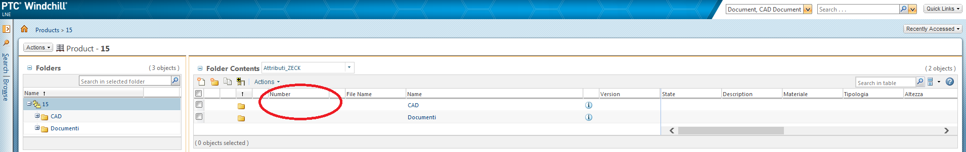

I can't set the number to folders in common space!

You cannot set a number to a folder, it would be a blank always, however when you create a WT part/ EPM document or any other Windchill objects inside the folder this column will be filled.
You can do that test, please create few documents inside the document folder you will get to know the difference

Here a picture to explain better, i need to fill the column number for every folder, where the red circle indicates.

I could be wrong but I don't think that's possible.
