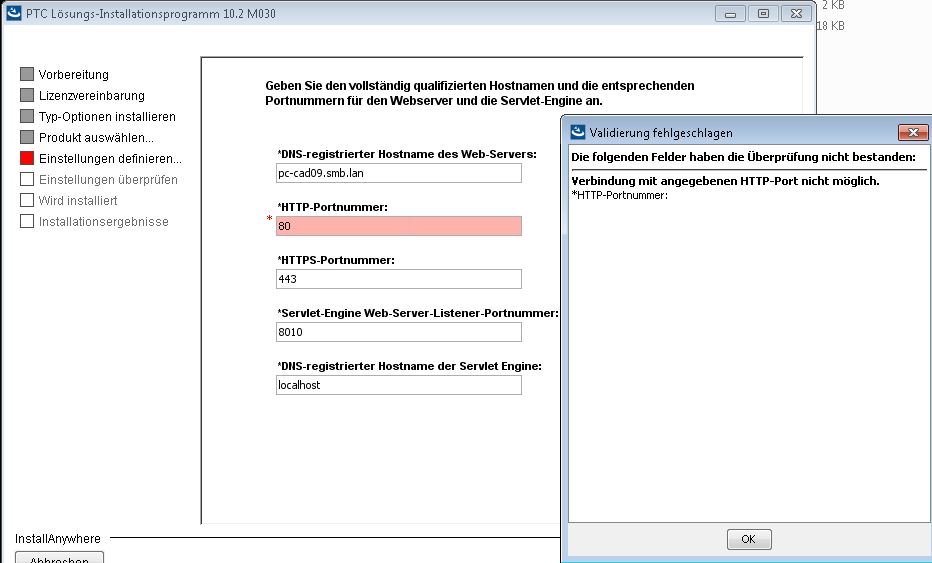

Hi everybody,
I need to set up a Windchill PDMLink test system. So I´m trying to install windchill on a local machine (don´t want to touch the prod server ).
As manual serves this http://ark-plm.com/monolithic-installation-windchill-pdmlink-10-2-windows-server-2012/
When using the PTC sollution installer, I´m getting a problem: "Connection with HTTP-port not possible" (not sure about the correct translation - message is in german). I am using standard port (see picture below) and firewall is off.
Any suggestions why I can´t reach the machine? Why is the installation process doing this test?

Hello Benjamin,
I think Tom's and Bob's answers are correct, you probably have some other program that is currently using port 80.
A quick procedure to verify that is to open up the command prompt, and type in "netstat -a -n -o"
source: http://www.techrepublic.com/blog/the-enterprise-cloud/see-what-process-is-using-a-tcp-port-in-windows-server-2008/
if you do have a program using port 80, take note of the PID of it, then open the task manager to find the process with that PID.

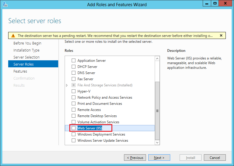

I would guess that port 80 is already in use.  Windchill needs to install it's own web server (Apache), so you need to turn off whatever is already using port 80.  Start by taking a look at IIS.  (Make sure it's not checked.)

A test WC system will also need a test Apache (HTTPServer) and test WindchillDS as well.  In this step you are setting up the Apache configurations.
Is "pc-cad09.smb.lan" the machine you are looking to install Windchill on as well as the machine you are actually running the PSI on?  If it is a connection error to Port 80, it is likely that something on that machine is already using Port 80.  You may want to do a netstat on that machine to verify.

Nov 9, 2015 8:56 AM UTC
Hi guys,
thank you for your advice!
The programm blocking port 80 is our anti-virus software (Trend Micro).
NowI did choose another port - hopefully this will work too.
Best regards
Benjamin
Nov 9, 2015 2:00 PM UTC
Keep in mind that if you choose a port other than 80 to install Windchill, then users will have to add that to the end of the domain name portion of the URL.  For instance, if you install on port 81 using the hostname in your screenshot and assuming the servlet name is "Windchill", the URL to access Windchill would be:
http://pc-cad09.smb.lan:81/Windchill
You will also need to make sure all clients in your environment have communications open/available on whatever port you choose to do the server-side install.
