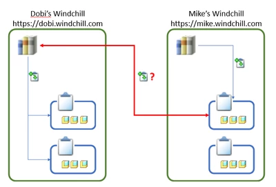

That's the use case today and that assumes that everything is running on a single instance.
Our vendors work in our instance today and we share data to ProjectLink for them to access. On their end (for the ones that use Windchill within their own companies as well) that means they have multiple Windchill servers connected. That's all well and good and works.
My question is whether I can share data from say a PDMLink in Windchill instance 1 to ProjectLink in Windchill instance 2 by just doing an Add to Project action?
For example: say you and I are working together. You have your instance of Windchill running and I have my instance of Windchill running. They are separate.
I want us to share data through ProjectLink so I set up a Project context in my instance and give you access to it. I can share data to the Project context from my PDM because it's in my Windchill instance.
You can get data from my Project context by logging into my Windchill instance and working within my Project context.
However, if you want to share data into that same Project context in my Windchill instance from your PDM - which is in your Windchill instance - how do you do it without exporting and importing?
22-Sapphire I
Jul 14, 2021 5:23 PM UTC
Nice diagram - very helpful.
To my knowledge there is no way to do that.  Packages were created for that primary use case, but as you note (w detail) there are some challenges.

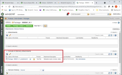

I ran into this a while back and the solution was the following.
I wrote a Java utility that does two things:
1. Creates a log of the metadata of the Persistables in a Package
2. Set the metadata of the Persistable using the log generated in step 1.
I guess you can see where this is going.
1. Create a Package with the Creo data
2. Run a java script the script that gets the metadate
3. Send Package
4. Target Windchill site imports the Package
5. Target Windchill site run the utility which reads the log and resets, if necessary the name, revision and state.
So far it has worked well and even considers if the new data is at a later revision that the existing data.
For example, the target system's latest version is B.3.  After Package import we now have B.4 but according to the log the revision should be D not B. The utility fixes this so now the latest is D.1
Ultimately, I created a custom action that the user could run from the Package info page to create the log and have it automatically attached to the Package's "Include in Delivery Attachments".
So far so it's worked well.
