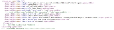

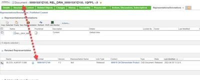

We do this partly through the afterEDRLoader process (renaming of the PDF's to include number and version) and publish rules. You can create a separate wtDocument that is linked as a related representable of the original CAD through publish rules.
https://www.ptc.com/en/support/article/CS348518?source=search
For publishing the additional files, you use the AdditionalFilesPostPublishDelegate in your Visualization Configuration Administration publishing rules
