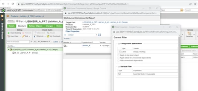

Do you men this attribute?
because OOTB "Collapsible Assembly" does not exists on a WTPart in the PDMLink
If I set this attribute to yes, the report still shows the child components.
Multilevel BOM and Multilevel component report do the same as before the change
PS> it is related to BOM Transformer and Variants not the BOM Reporting.
Collapsible Attribute Set to Yes
Collapsible Attribute Set to No

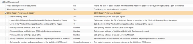

the system allows you just exclude a gathering parts from the report by preference Filter Gathering Parts
As I know there is only a way and it is customization.

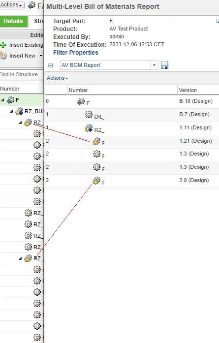

I guess that inseparable is set on the assembly, which should be part of the BOM report. but used parts on the lower level of that assembly shouldn't be part of the BOM report.
I know the case and I don't think it is possible to set it by the filter.
One our customer needed same report with different conditions.
I wrote own BOM report for him.
example what I understood
