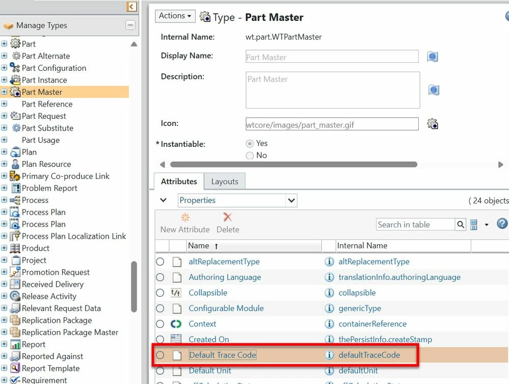

How to update a part master attribute by utilizing loadFromFile utility?
Version: Windchill 13.0
Use Case: I have to do a mass update of the "Default Trace Code" attribut that is located on the Part Master.
Description:
typically use the LodFromFile utility to update attributes on WTParts and WTDocuments. To do this, I first create a CSV file following the format outlined in [Windchill_Home]/loadFiles/csvmapfile.txt. I then convert the CSV file into an XML file using the csv2xml utility.
Currently, I need to update the "Default Trace Code" attribute across multiple parts. However, I haven't found any documentation or guidance on how to create a suitable loader for Part Master attributes.2025-09-29_15-31-05.jpg

If not too many, this can be done via edit multiple object in a search results. Even thought this is master attributes, it will check out and check in the item, but you can edit master attribute, I believe. If that works, you can do these in batches very quickly. How many parts do you need to update?
Sep 30, 2025 5:55 AM UTC
Thank you for your reply. The "Edit Common Attributes" function only applies to a single part at a time. In my case, I need to update over 30,000 parts, so this approach isn't feasible.

You can look for the parts in search , select and export parts as Importable spreadsheet  ,set the trace code and import back
