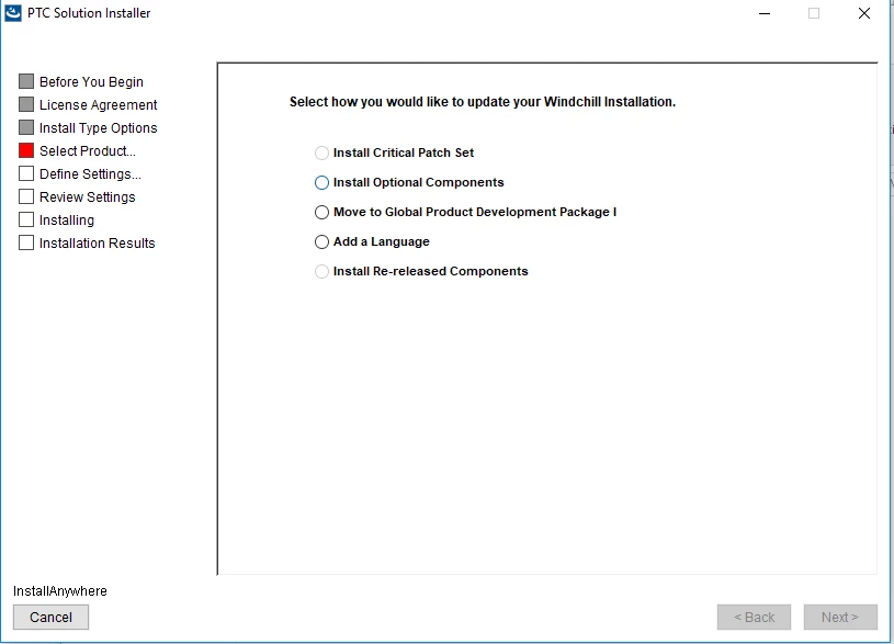

Has anyone updated Windchill PDMLink 11.0 M030-CPS13 bundle on an existing Windchill 11.1 M010 installation?
On running PSI, the update existing (Install CPS) options are greyed out. Have checked the articles that says about the PSI installer bundled with different versions might cause it, which is true in my case.
So I want to know what is the way to get this bundle installed on 11.1(M010) version, I need it since it has has the latest RestService 1.3 module. Any suggestions/clue will be appreciated.

You cannot install the 11.0m03CPS13 on 11.1m010!!!!
Each CPS is tied to a specific release of Windchill.
The latest CPS for Windchill 11.1 m010 is CPS04.
