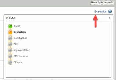

To know the current state for CAPA request, you can click the state hyperlink at the right top corner on info page to launch this diagram:
