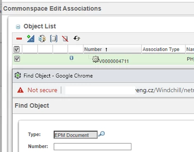

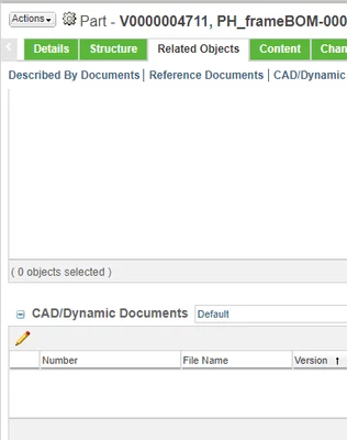

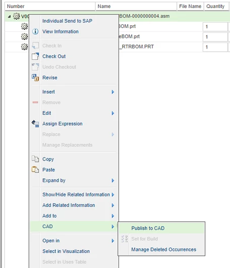

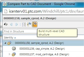

Create new CAD Assembly,
connect the CAD Assembly to generated WTPart
Search for the CAD assembly
In the structure use Build to CAD
The Publish to CAD will propagate WTPart structure that have associated CAD parts to the new CAD assembly.
