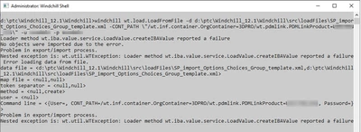

 but going deeper, customer wants to load group with custom IBA defined. So my file is
<?xml version="1.0" ?><!DOCTYPE NmLoader SYSTEM "standard12_1.dtd">
<NmLoader>
<csvOptionGroup handler="com.ptc.windchill.option.load.Loader.createGroup" >
 <csvname>Groupa 1</csvname>
 <csvoptionTypeDef>com.ptc.windchill.option.DesignOption</csvoptionTypeDef>
</csvOptionGroup>
<csvIBAValue handler="wt.iba.value.service.LoadValue.createIBAValue" >
 <csvdefinition>SP_GROUP_GROUP_DESCR_EN</csvdefinition>
 <csvvalue1>english group description</csvvalue1>
 <csvvalue2></csvvalue2>
 <csvdependency_id></csvdependency_id>
</csvIBAValue>
</NmLoader>
as a result
Question: what is wrong? How to debug to get more info?
Any idea??

HelesicPetr
Oct 31, 2023 2:10 PM UTC
Hi @Gucio
You need to place the IBA definition between begin and end elements for the optionsgroup so you need to find correct definition in the csvmapfile.txt for the option same as the csvBeginOption and csvEndOption
but if the definition does not exists, it is not possible to set the IBA definition for the option group
 PetrH
