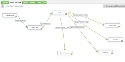

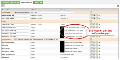

I believe that I need to use sub-select on my report.
I am creating a report that counts the number of released parts per ECN.
The report needs to list attributes related to subtypes of Parts in my organization.
It causes multiple lines since for each subtype there will be a new column for the attribute...
I understand that If I use sub-select, I can run the query and concatenate the result in a way to have the attribute in a single column.

In this case I think you should use the database function concat, or another way could be to create multiple queries and union them

I think you can use the Database function "concatenate" in this case.
The Part will only have 1 subtype, so if you concatenate the value of all the subtypes together, you'll get something like "null, null, Value, null". The end result will be just the value you care about.
Here's an example where I do something similar:
