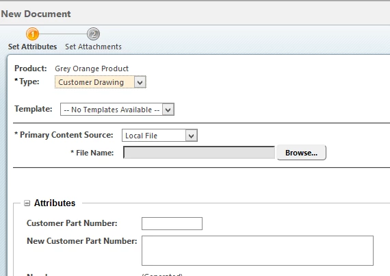

I am working on one UIValidation where I need to validate the two attributes (customer part number, new customer part number ) of New Document wizard page,
currently I am trying this is on acion=createDocumentSetTypeAndAttributesWizStep  but not working can any one please tell me how should I use this
