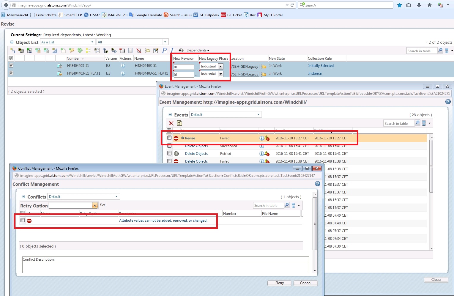

I am having trouble revising;below is a screenshot of the error
The error in Conflict management reads as follows
Attribute values cannot be added ,removed or changed

Hi Joseph,
Refer the below support article. There is an SPR raised against this issue.
https://support.ptc.com/appserver/cs/view/solution.jsp?n=CS226716
TomU
Nov 16, 2016 1:25 PM UTC
Is there a workaround???  The article hasn't been updated in over 9 months.
TomU
Nov 16, 2016 2:40 PM UTC
I just pinged tech support.  There is no workaround and the SPR is tentatively planned to be addressed in Windchill 11.0 M030.
