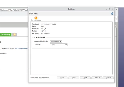

I am new to using WT parts
How do I attachment documents like PDF or word documents to the WT parts after I create them?

Aug 11, 2022 3:49 PM UTC
Checkout and Edit the WTpart
On the first screen, edit Next
On this screen, you can browse and upload any related documents you need.
When done, check-in the WTpart.
Aug 11, 2022 4:01 PM UTC
Thank you
The next button is grayed out, so I am lost.

Then your system admin needs to modify Windchill preferences to allow secondary content.
In Organization or Product preferences, have them look for Part Management and then set Attachments on Parts to Yes.
