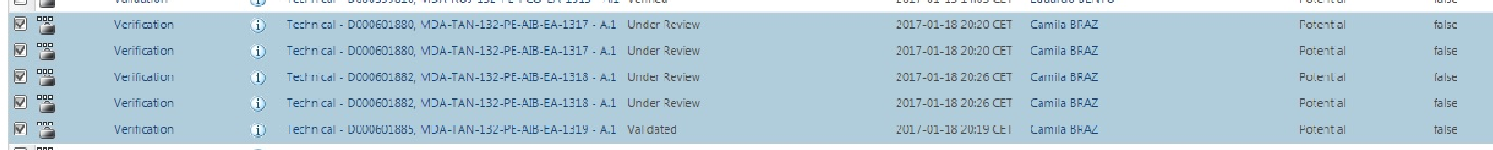

I am seeing duplicate workflow triggers at the same time.

How does same object trigger the workflow simultaneously twice.

Check the participants of the Verification activity.
If 'camilia BRAZ' participates in 2 roles in this activity , then 2 tasks are assigned to her.
