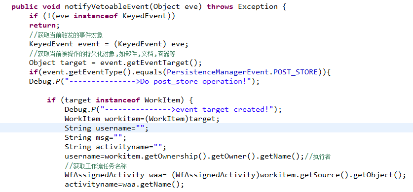

I can't add a listener of WorkItem objects
this's my codes, and i can't catch the event target of workitem.
can you help me ,thank you!

Mar 30, 2016 12:01 PM UTC
Try this
if((event.getEventType( ).equals( PersistenceManagerEvent.INSERT )) && ( target instanceof WorkItemLink))

è吕1-VisitorAuthor
Mar 30, 2016 12:24 PM UTC
thanks for your answer,and how can i get WorkItem with WorkItemLink ?
2-Explorer
Mar 30, 2016 12:46 PM UTC
WorkItemLink workitemlink = (WorkItemLink) target;
WorkItem workitem = workitemlink.getWorkItem();
