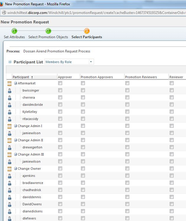

1st question:  By default, if a reviewer and/or approver is not selected, the request is routed back to the submitter. We do not want that, so is there anyway to make it mandatory that the boxes must be manually checked before submitting?  I know we can enter users under the promotion reviewer and approver roles so they will appear automatically, but we want to manually select the users because they will be different users depending on the request.

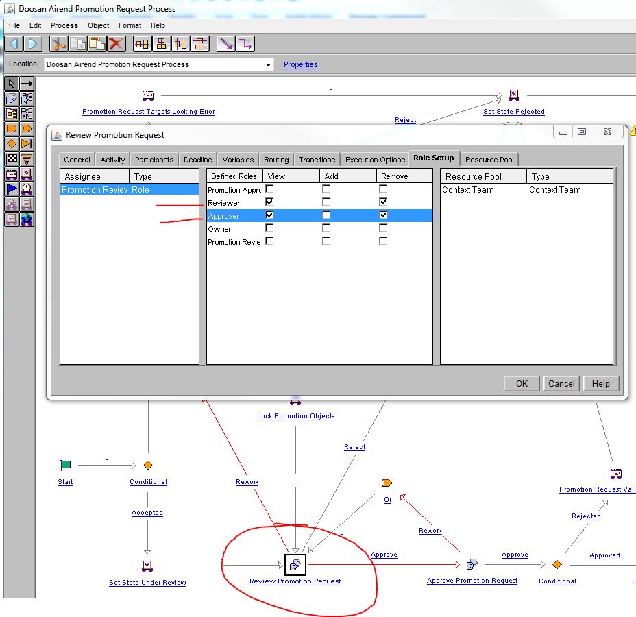

2nd question:  We have a customized workflow where it goes to reviewer first, the reviewer must accept or rework or reject.  If accept, it routes to approver.  As you see per below, we have 4 columns, we want only 2 columns per (OOTB).  We have removed the Promotion Reviewers and Promoton Approvers roles with the Context Team to see if that would do the trick, but no luck.................Any suggestion on how to remove Approver and Reviewer columns?
Within the workflow, I can click remove the Approver and Reviewer, but it always comes back.

Jul 3, 2016 6:56 PM UTC
Your 1st questions solution is possible but through customization not OOTB configuration.
For your 2nd question.
The no of columns of roles = cumulative no of Roles mentioned in Participants tab of the activity in the whole custom workflow process.
i.e If in your custom workflow there are total 6 different types of roles mentioned then the no of column available will be 6.
Whenever you are checking/unchecking Add,Remove,View for a particular role in Role Setup tab, that's applicable for only that particular Set Up Participant activity task.(In your case the name of the activity is "Review Promotion Request")
In order to remove those two column you have to remove those two roles from every activities Participant tab, email robot etc.
