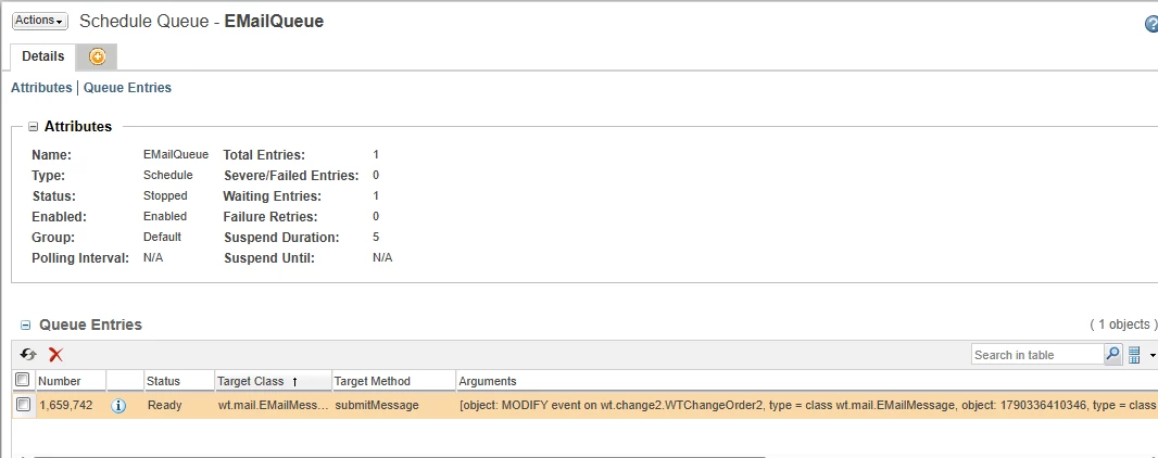

I have created a Subscription for change Notice but not emails triggers in windchill 12.0

7-Bedrock
Sep 24, 2026 10:44 AM UTC
I have verified all of this
Enabled even on Change Notice Object on Edit attributes,Edit Contents and I have tried editing Change Notice but not the same another change notice from the same context no entry popping up in the Email queue no emails but it happens only for the Change Notice which is there in the Subscription.
7-Bedrock
Sep 24, 2026 10:45 AM UTC
I want to enable subscription notification for every change notice which is available in the Product when it is edited it should notify.
HelesicPetr
Sep 24, 2026 11:45 AM UTC
Hi ​@GP_13665873
It is very simple. Add the notification rule in the Policy Administration.
I test it and if you change the Cange Notice object then email is sent.
Just add a note: Do not expect the email if the Change Task object is changed.
If you set a subscription for ChangeNotice the email is not sent if just ChangeTask is changed. .
You have to add another rule with that type of object. Change Task.
Check your email queue on a site. You can try to stop the queue and modify the CN and check if the record is added,
Here is an example:
if the email queue does not contains new record for the email, your notifications are not correctly configured in the policy administration on the product context
PS:
the subscribe function is used only for one specific object not for a specific type of all objects
