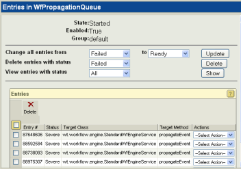

So you have a queue that looks like this:
You are having workflow issues and PTC Tech Support recommends you restart all these Severe tasks (robots may be in another queue, I forget which, oh and BTW, this did happen).  The workflow has finished and your change notice is released as well as the changeables.  When the task is resumed, it can now complete, and it does, setting your changeables from Released to Under Review. Nice. But wait...there's more.  Since this is a workflow, it starts re-executing the next task from that position in the workflow. The workflow rises from the dead and comes back to life.  WorkItem tasks are sent out again and users get all confused. What's worse, you've lost data integrity since released data can start changing on you.
The takeaway - put some error checking around set state robots or bots that can fail (redirect to user task to try again) and never blindly restart queue processes without knowing what they do.  Clear out failed robots that you continue past so they are gone for good.

I see your point and also share some of your thoughts. But since 10.0??? (or 10.1) we implemented some business rules to exatly wait until all rules are good. Otherwise the workflow can't go on.
This rules can be checkedout objects, missing line numbers, parent child phase check, part document checks, etc. Since we implement such rules, most of the workflows run smoothly and we won't need to restart any workflows.
And if you restart the workflow, you have to terminate the current one, otherwise things like you described are happening.

Just got to 10.2 and Business Rules are high on my list. In my example, the workflow was closed but the "severe" task that was skipped remained in the queue. Perhaps it has been fixed. Will keep an eye out for it.
