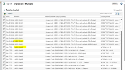

I want to see the BOMS where both items are used.
Reference from another topic.

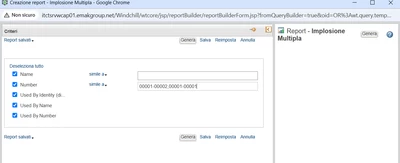

It works well, thanks! but insering for example a couple of items i'd like to see the boms where both are used.
The system reports me the boms where each single item are used, not both are used.

You have to select twice the attribute for which you want both conditions to be valid, and then you have to use the AND criterion so that both selections are valid at the same time.
Marco
