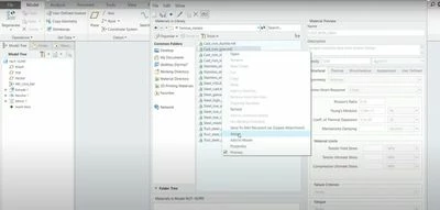

Jul 11, 2024 12:41 PM UTC
Thanks for the reply @avillanueva
Please see the below image. There are collection of materials in the Creo library.
I want to understand on
1.)how these materials are managed in windchill side. (as an EPMDocument of type=MTL?)
2)how can i further link these materials on EBOM WTParts?
3.) What is the best strategy to consider while doing data migration of Materials to Windchill?
Thanks in advance
