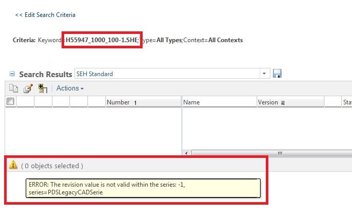

I was trying to search for an object (a medusa file);Can any one help me with the significance of the error attached in the screenshot?
I'm not sure if the object is present or not present in Windchill

The object you are searching might be at -1 revision, but the value does not exist in Revision series.
Have you made any changes to the Revision series?

There was some revision naming issue hence this object was not visble.My seniors were able to check get the required revision from DB.\
