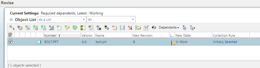

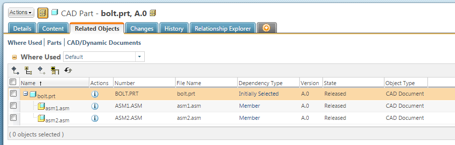

Hi everyone,
If a part(not a standard part) is used in multiple assemblies if we want revise the part then the related assemblies are to be revised.
when we revise that part i am not getting the option in collect objects where the object is used.
if that part is revised i want revise the assembly also.
i had kept some screen shots for info.
Who can i do this?

This is the classic case - how far up do you incorporate changes?
For development, in general people do not Rev the where-used objects.
After Release, the general rule is that if Rev B and Rev A parts cannot be placed into the same bin on the production floor, then rather than Revise, one needs to create a new Part Number and manage it's use in the next higher assembly; with a similar consideration at all higher levels.

This was a rare case if that happens and the part that was changed has to be affected in both assemblies then what should i do,
And is there any option to collect the objects where the part is used.
When i revise the part to REV B i want my assembly to be revise to same revision of REV B even for single assembly,can this be done ?
