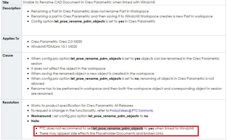

If i change this "let_proe_rename_pdm_objects" property in Config.pro file for Creo does it affect a system integrated with Windchill?
