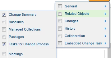

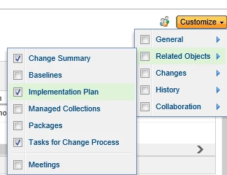

Has anyone noticed that I.P. is not available to be selected from the "Customize" button in version 12?  We have a custom page for our users and that is the first one on the page.
This is version 11.0 M030
Version 12.0.1.1

What is your Change Notice with Embedded Change Task preference set to?  Was it changed during the upgrade?
In your 2nd screenshot from 12, you can see Embedded Change Task at the bottom of the Customize menu.
