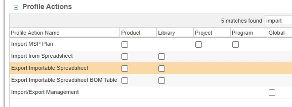

Hi @HelesicPetr,
Do you have any idea,
How we can allow external partner user to import BOM into Project container.
Also created one profile by name Product Engineer and provided access to Product Engineering team so they can send BOM/Part/Document from Project to Product container.
Below actions are enabled for External Partner user:
Create New Part/BOM/Document

Hi @V_B_THAKARE
No way 😄 the function is not supported for the project
Profile should allow you to show the function but for the project context it is not available.
So only product is the right place.
If you want that external partner could create the BOM from spreadsheet you need to create product for the external partner and allow them to access only to that product.
