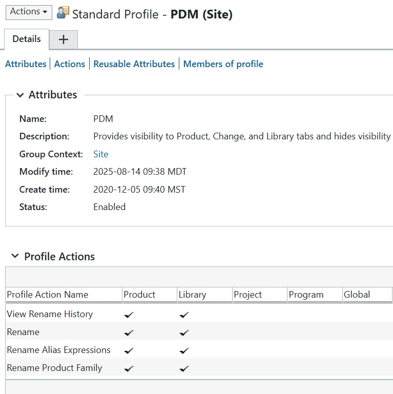

This could be a profile feature. I know at one point that the button visibility was tied to profile driving the visibility.
