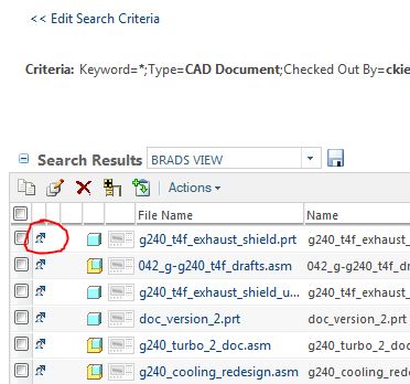

In a Windchill search, is there a way to search for checked out modified CAD files in other users workspace?

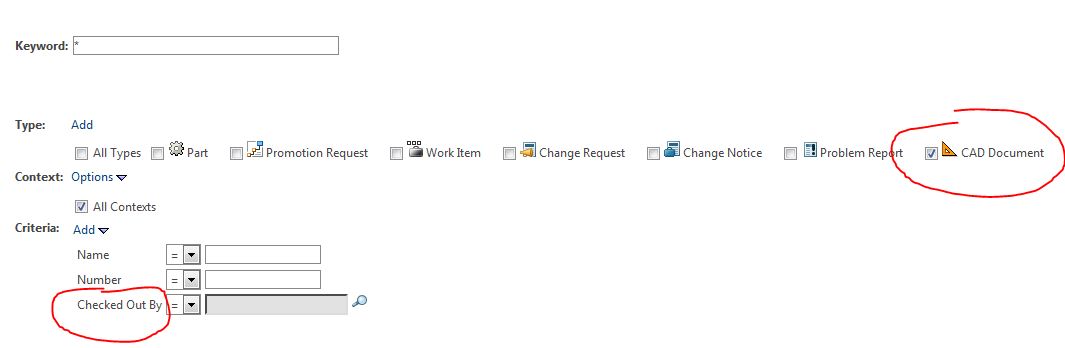

I know you can search for files that are "checked out by", but I want to know if there is a way to see if those checked out files are actually modified in their workspace?
The below results show all the CAD files that are checked out by the particular user, just trying figure out those files are modified or not.  Does anyone know how this can be done, if it can?

as an org admin you can see the server side workspace of anyone.
However, if the user has not uploaded the data, they may still appear unmodified in the server side workspace but are actually modified in the client side workspace.
I do not know if such permission can be granted to end user.

On my previous server, as Org Admin, I could see objects in server side workspaces. In the search results, in order to know where the object was, I added the column Cabinet.

Not using a search, but can be done with a relatively simple query builder report. I have this in place here.
