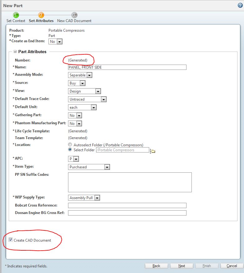

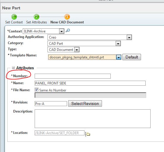

Within my workspace.......I want to create a new WTpart and CAD doc at same time using the same number generated from Windchill. Can this be done? Here are my steps, then my problem.
So in the next screen below, the number field is empty and is required to fill out. I want the generated number from Windchill to auto populate this field for the CAD doc. I want the WTpart and CAD doc to have the same number.

As far as I'm aware, there's no OOTB way to to this. We wanted to do something similar, but could only think of complex customisation, which we didn't have time for. We opted to hide the 'Create CAD Document' tick box on the Part creation screen. I'd bet someone on here has gone to the trouble of writing code to do this.
Perhaps worth submitting an Idea for an OOTB method?
