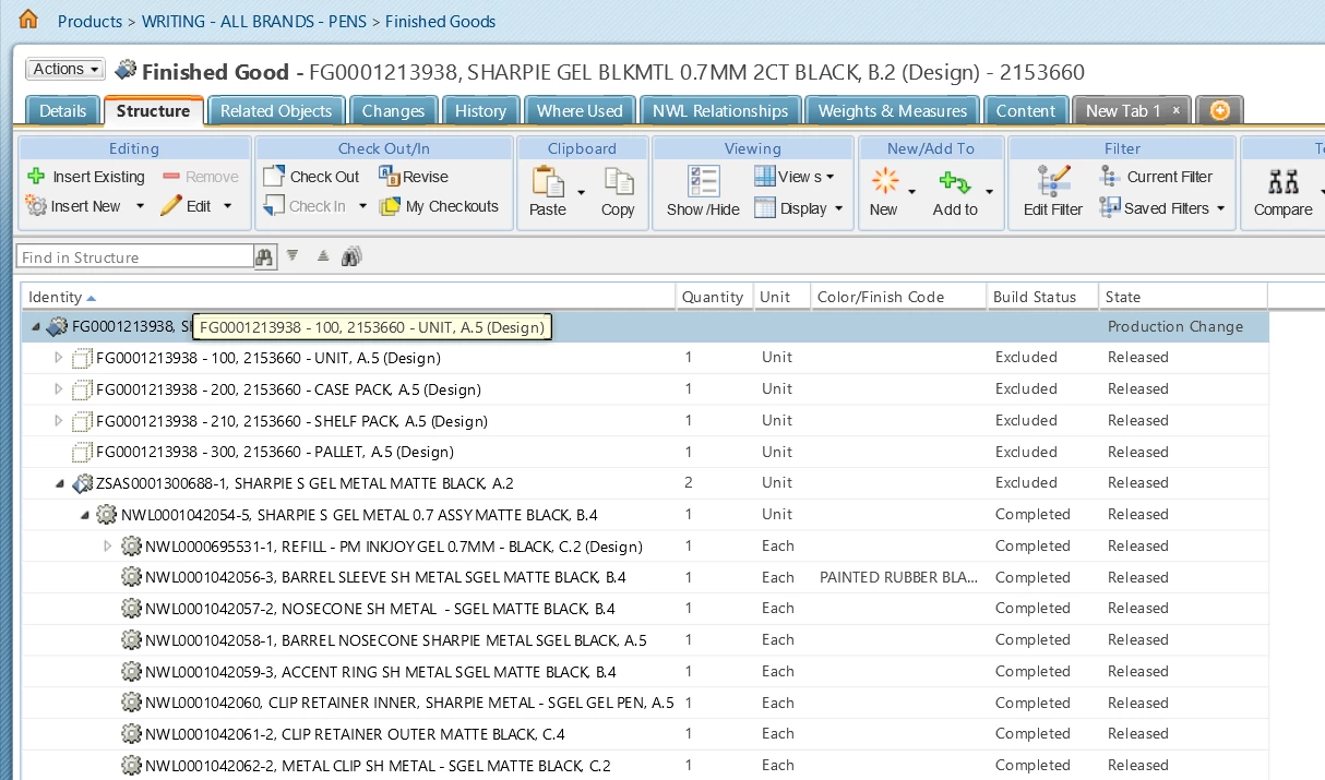

In Product Structure - Can the wt part Version appear in separate column
Is there an option in Windchill, to view the Version of a wt part from the pStructure tab
joe_morton
Sep 15, 2021 1:51 PM UTC
You can do this by customizing the view. See: http://support.ptc.com/help/windchill/wnc/r11.1_m020/whc_en/index.html#page/Windchill_Help_Center/UserSetupTableViewNew.html
Basically: Views -> Manage Structure Views
From there, you can either edit the current view, or do a save as on a current view, then add the additional columns you want.

Sep 16, 2021 2:29 AM UTC
Thanks it worked.
