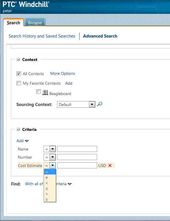

Ed,
The ability to have classification attributes included within the advance search criteria is planned for the next release of Windchill.
As for the different operators, these are available depending on the attribute type. See image below.
Jim

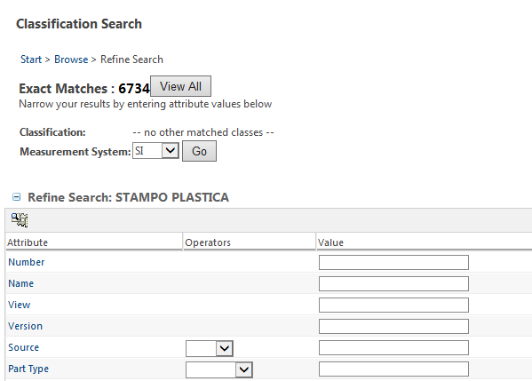

MarcoTosin
Mar 12, 2015 10:11 AM UTC
Edmund,
what you are asking for is the standard behaviour of PartsLink.
Once installed and configured you have a special search, called classification search.
From there you can drill down classification nodes or use search operators.
See attached pictures.
Marco
