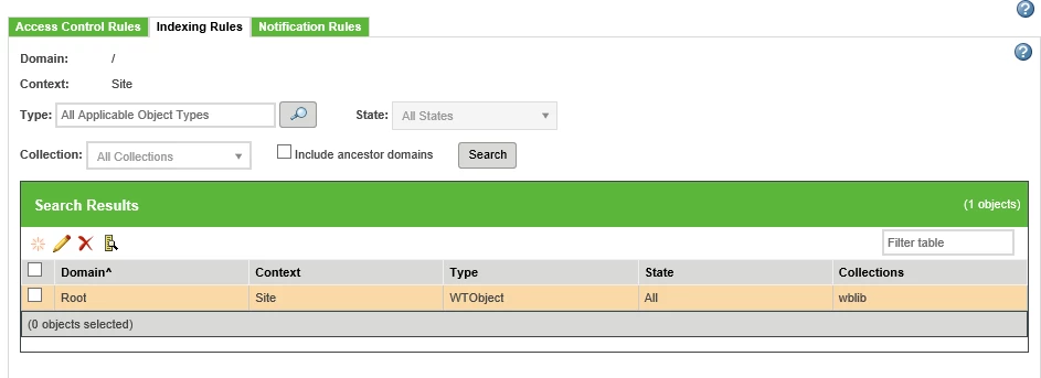

we have the index search enabled and the solr service running on our Windchill server. Unfortunately, the index search is not working.
In the policy administration, there is the default setting to index all objects:

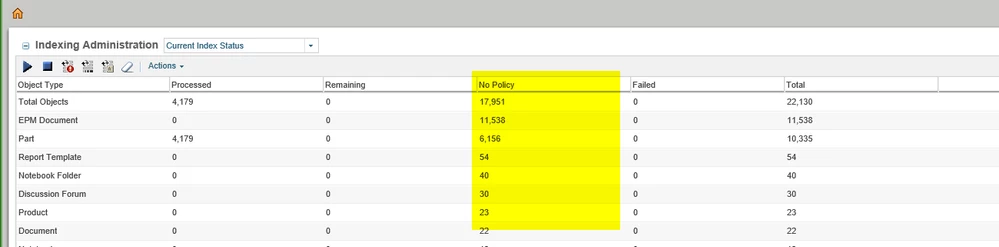

However, the indexing administration tool shows lots of "no policy" objects:
Can anyone give me a hint how to debug this further?

Issue solved.
Although the index search was enabled in Site > Preferences > Search, I had to set
wt.index.enabled=true
in WINDCHILL_HOME/codebase/wt.properties.
Indexing is working flawlessly since then....
