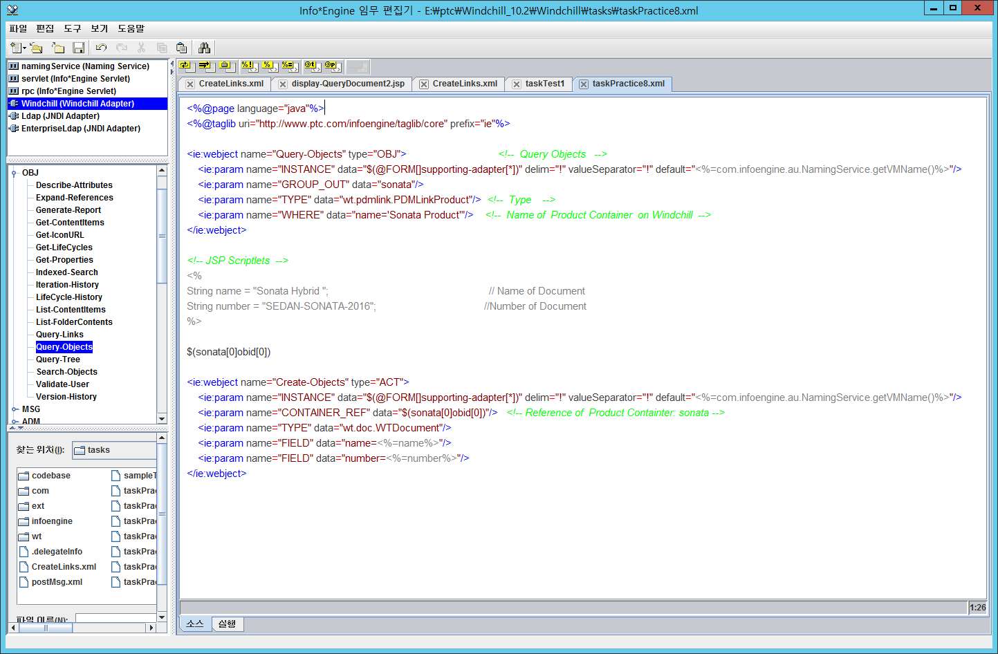

   Info*Engine Editor

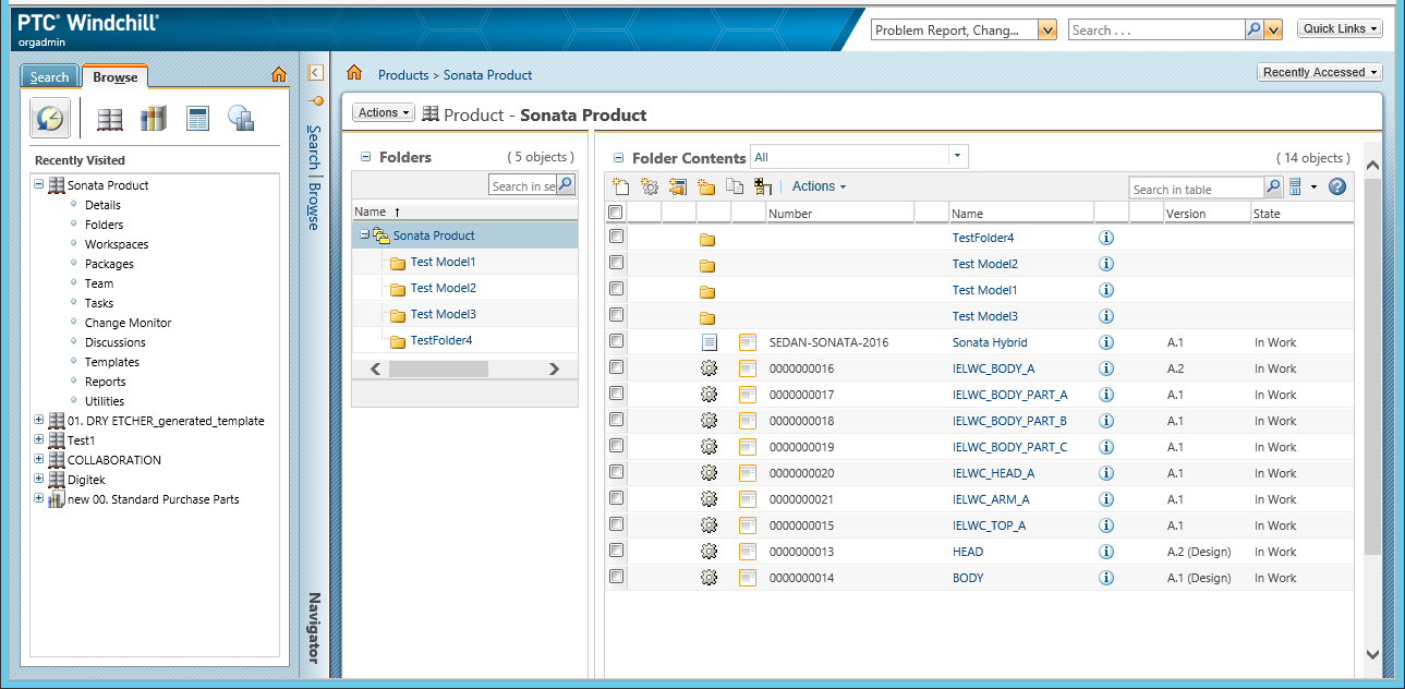

   I created a simple sample of Info*Engine for you.
   It creates a document through using Info*Engine. It makes a document named as Sonata Hybrid.  Please look up the tags below. ex1.png
   Windchill
  The document is created in Sonata Product container.
