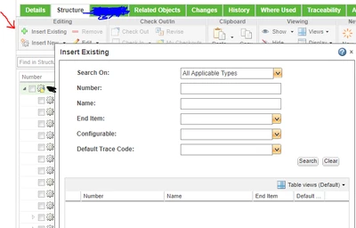

Hello guys, is there a way to add multiple existing parts when modifying a BOM?
Instead of adding one per one, it is allowed when creating new parts "Create multiple parts"
But not when already created
Could you please help?

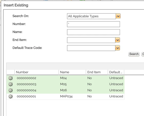

Jun 13, 2020 8:28 PM UTC
I just tried in PDML 11.2 and you can select multiple parts while insert existing. Use shift + select
