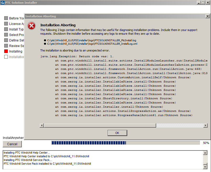

Will run through the steps which I followed to install windchill 11 please help me out
1)Install and configure oracle in other system
2)Run PSI and link to oracle
3)Check all prerequisite and install windchill 11
4)Installation Aborts by following error

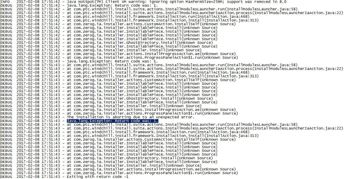

5)Checked log file it shows as follows
Guys please help facing these issues on installation
java.lang.Exception: Return code was: 1.
Feb 8, 2017 1:42 PM UTC
PSI aborts with java.lang.Exception: Return code was 1 because of No disk space for Windchill PDMLink
DescriptionPSI aborts with java.lang.Exception: Return code was 1 because of No disk space

    • Increase the disk space and re-run PSI

‌Could you attach the entire MS log?
