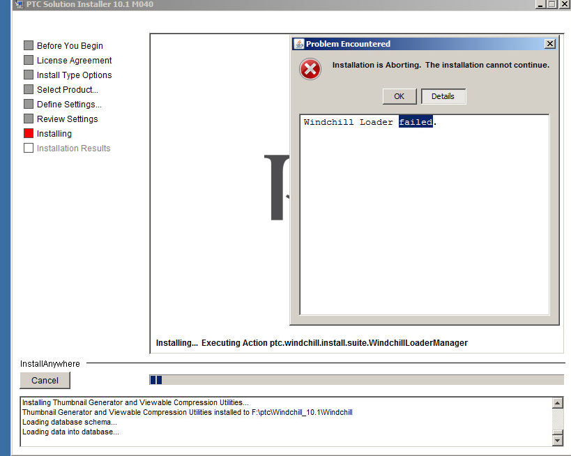

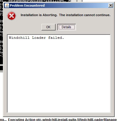

Installation problem - windchill 10.1 M040
Hi, During installation of Windchill PDMlink 10.1 M040 with Oracle 11g R2, it is failing with error message "Windchill loader failed'. Can any one support on this issue.

KGH1-VisitorAuthor
Jan 21, 2014 11:43 AM UTC
I'm installing only PDMLink with creo view, thumbnail generator and RFS support checked.
I have attached the snapshot. It throws after install all including thumbnail generator. At the stage of loading data to oracle but I'm sure there are no issues with oracle installation. It just went smooth and with default settings. No customization at all. I had installed successfully before.
For oracle uninstallation, i used deinstall and rebooted. Later deleted the the oracle folder remains.
I can uncheck and try the installation but help with the procedure / commands on how to load demo data.
One more doubt is there any version compatibility issue between windchill and oracle. Windchill is 10.1 M040
and oracle is 11g.
Do you need ocu installer log file.

Jan 21, 2014 2:19 PM UTC
The Windchill Loader is a PTC application to load Base data and Demo data into windchill. Base data are types, object initialization rules, and so on. Demo data are examples such as the Golf Cart product and part structure. It is unlikely to be an oracle problem.
The way to investigate is to review the Method Server logs for exceptions related to the Windchill Loader. Then you might need to open a case with customer support.
Jan 21, 2014 3:31 PM UTC
When I saw this on a DEV machine, it was down to a memory issue durnig teh load process. Basically Oracle was trying to use too much memory.
I resolved by limiting the memory targets on oracle to suit the machine.
KGH1-VisitorAuthor
Jan 22, 2014 11:29 AM UTC
succedded. correct Simon, it is becasue of lack of memory which application needs during loading schema / demo data. I could able to complete installation successfully by increasing the memory capacity.
Thanks for all of you for suggestions and supported me to fix this issue.
